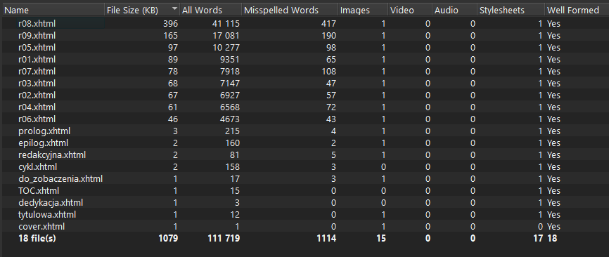

Strange.
I did a full clean build many times.
Fresh ZIP file from github etc.
The main.cpp idea was causing an error during the build.
W:\Develop\Sigil\Sigil-master\src\main.cpp(146): error C2761: "void QLocale::setDefault(const QLocale &)": Ponowna deklaracja składowej nie jest dozwolona
[ang. member function redeclaration not allowed]
Anyway setDefault for QLocale: If this function is not called, the system's locale is used.
In the attached gif I show the problem.

I just can not figure out why your QLocale().toString() function and QLocale(QString).toFloat() can not be properly working. It seems to work everyplace.
And how can the text "66.82" can not be converted properly to a float is very strange.
I know some locales use "," as a group separator and some use commas as a decimal point (like France). Other places use blanks or non-breaking spaces as group separators.
Since that value is generated by QLocale().toString() that same QLocale().toFloat() should handle it.
So for Poland:
what is your locale decimal point, and thousands group separator characters?

So for Poland:
Decimal point: comma
Thousand group separator: space

Old 07-17-2024, 01:04 PM   #14
BeckyEbook
BeckyEbook's Avatar
Posts: 1,076
Karma: 4000129
Join Date: Jan 2017
Location: Poland
BTW: After changing the code in the report to 0 decimal places, the sorting works nicely (but that was to be expected).

Old 07-17-2024, 01:24 PM   #15
KevinH
Sigil Developer
Posts: 10,139
Karma: 7640000
Device: many
Oh, but your image for file sizes all show decimal points as '.' not a comma.
That is freaking out the QLocale().toFloat().
So I am missing the use of QLocale() to generate the file sizes and that is what is causing the trouble.
Let me see if QString::number() has a QLocale equivalent.
