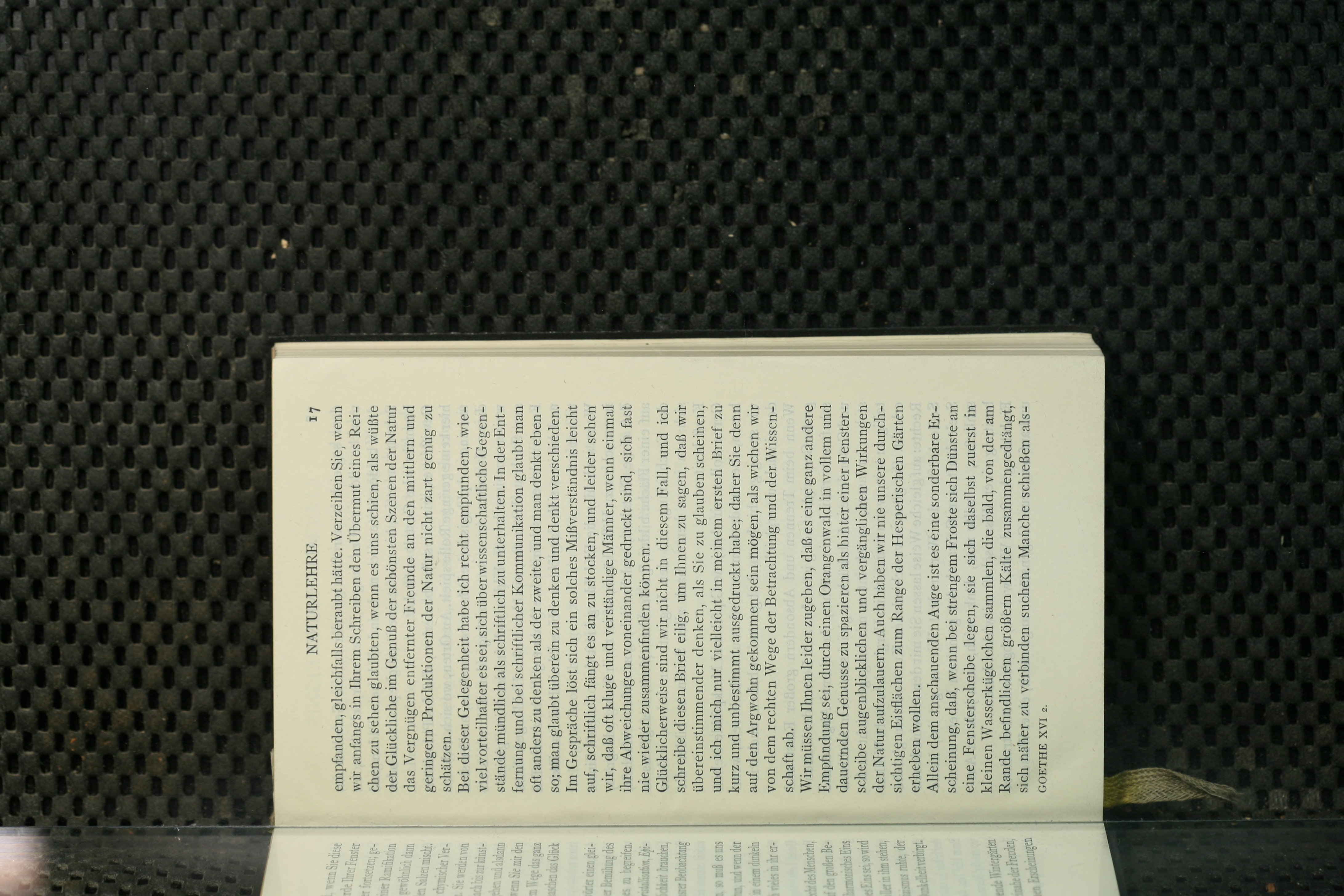

Post Tutorial-from Paper Book to Ebook PDF - 400 pages in 4 hours
Hey guys
There are many techniques for scanning a book, but many of them either require investment in the purchase of expensive equipment or cost a lot of time to finish the job.
Thinking about it, I gathered years of experience to develop a tutorial that allows you to build a PDF Ebook from:
- Paper book
- Goose neck cell phone holder
- Computer
With productivity of 400 pages in 4 hours. High visual quality.
The tutorial is very detailed, with more than 30 pages and still in the process of incrementing.
If at least 1 person feels satisfied after producing their first PDF Ebook from this tutorial, all the hours of effort developing it will have been worth it.
Unfortunately, the material is currently in Portuguese, but will soon be translated appropriately into English.
But you can check it out with the auto-translated version of the link below:

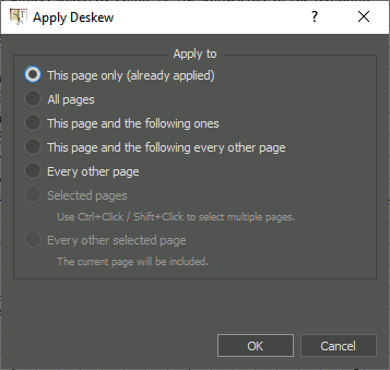

I certainly does not wish to indulge in page by page settings, through many manual tweakings, though I willingly admit there are some botched/damaged pages that may require some special treatment.
Then you'd set the setting once, then "apply to all pages" (or only even or only odd):
It would act the same as the old Scan Tailor.
Below almost all settings, there's a little "Apply To..." button, and you get those options.

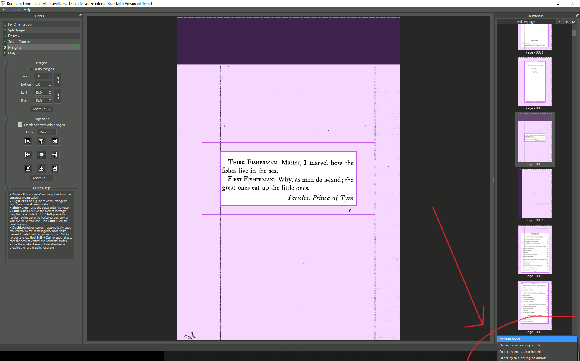

So many other little QoL improvements too, like being able to sort images in the Margins step:
Again, the original had no choice. But Advanced includes the original functionality AND more:
  • Natural Sort
    • Default. (And this was original Scan Tailor.)
  • Order by increasing Width
  • Order by increasing Height
  • Order by decreasing deviation
This becomes invaluable for finding/correcting some of the bad pages.
The vast bulk of pages take up the entire page, but some might only include chapter titles, a single small blockquote, or a few sentences and the chapter would end.
The original Scan Tailor would completely botch those pages during the Margins step, and it would be difficult to even spot which pages were the problem when trying to "Match size with other pages".

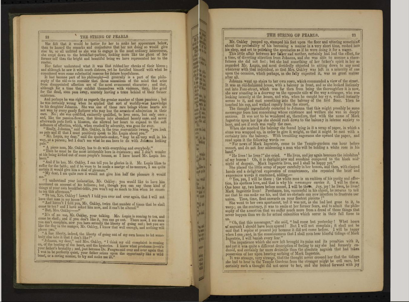

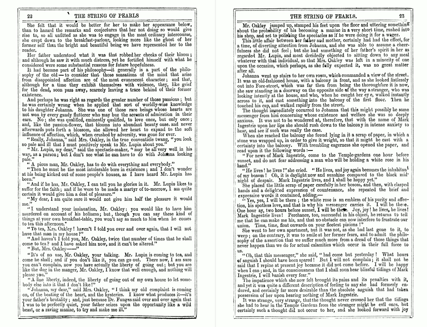

Yes, that dewarping by grid is incredible.
When GrannyGrump was working on a digitization of the original Sweeney Todd book:
Rymer, J. M. "The String of Pearls; or, Sweeney Todd, The Demon Barber of Fleet Street"
Here's the original Archive.org PDF:
https://archive.org/details/stringof...e/n13/mode/2up
ID:	186689 Click image for larger version

It had 2 large issues solved by Advanced:
  • Left/Right pages were accidentally photographed at different distances.
    • So Left text slightly smaller (probably 90%) size of the Right pages.
    • I was able to easily find/correct all bad pages by using "sort by width/height" mentioned above.
  • Many curved pages
    • This became even more noticeable because every page's text actually had a rectangle box drawn around it.
    • Luckily, I was able to use Advanced's automatic mode to get me most of the way there, then manual grids to "straighten" based on the rectangle instead.
Finereader only handles that basic "Trapezoidal" problem, if the camera was angled too close to the ground. And the rectangle completely ruined their algorithm to detect wavy text.
Original Scan Tailor didn't have automatic dewarping.
Sadly, I recently cleared up some space and deleted the original source files for that project... or I'd show you more detailed before/afters.
