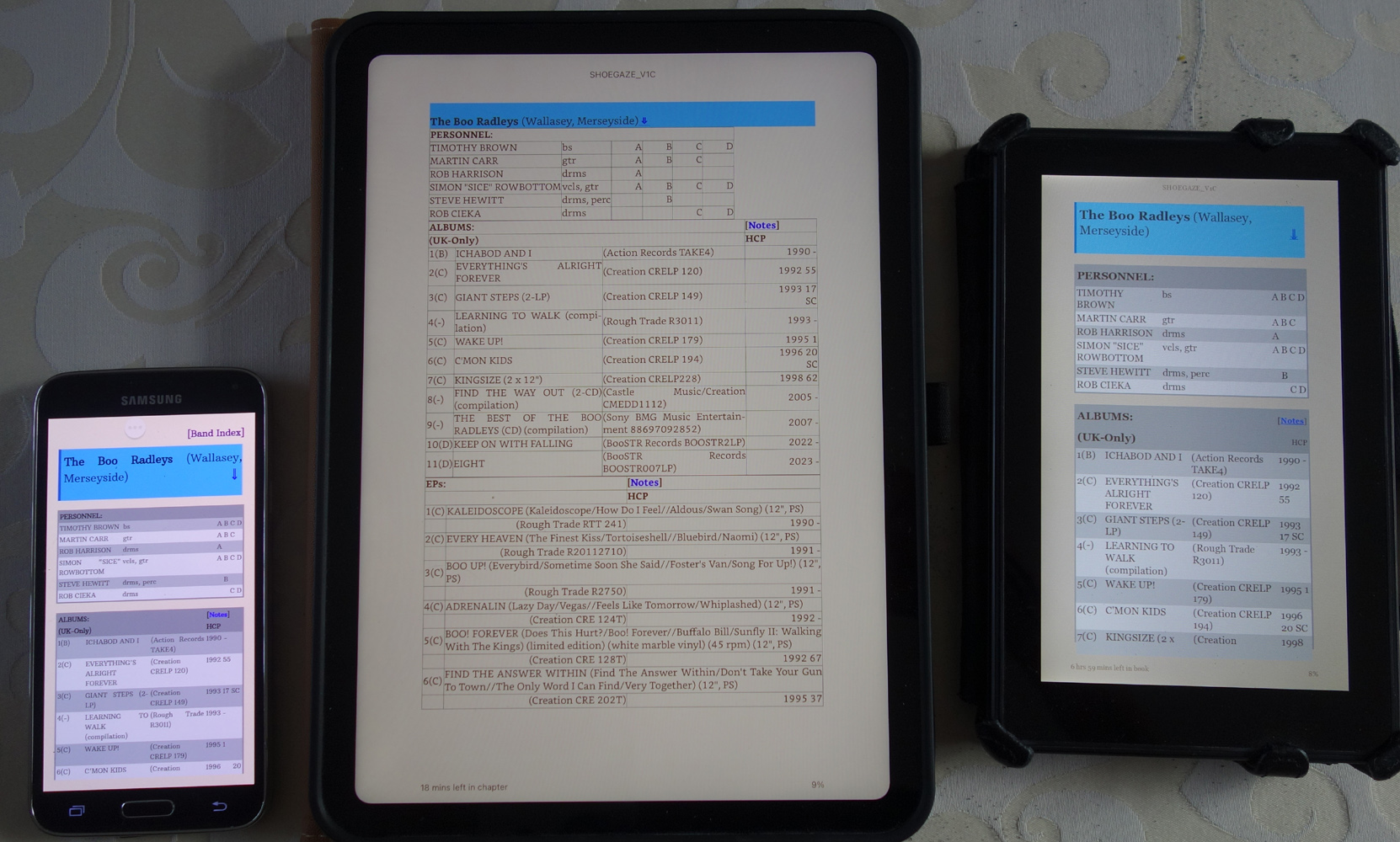

Thanks all... I thought I was getting somewhere. @Quoth's recommendation to test on Lithium/small screen was useful & I added a media query to reduce the font size in the tables. However, when I test on both a large iPad & small iPhone most of the CSS looks like it is ignored & the result is no good. The attached shows a sample displayed in an my wife's old Android phone, iPad & Kindle, delivered using the Kindle app & 'send to Kindle' to website.
Is there any way to solve the problem on Apple devices?

You can't make it work by reducing the font! One of the best features of ebooks is the user's ability to change font size.
You need to make information be in sequential blocks.
The iOS (iPad and iPhone) rendering depends almost entirely which app is used.
