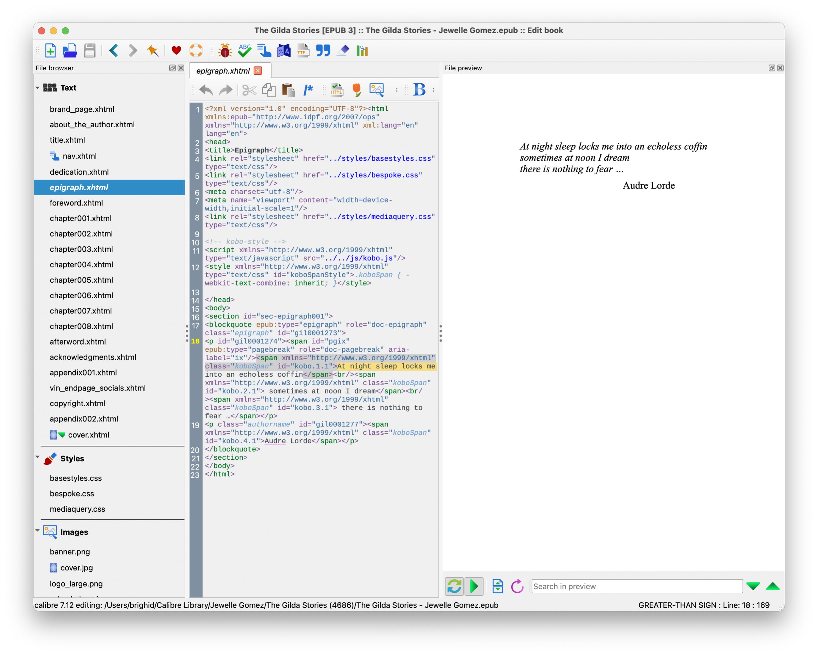

I realised it might be easier to discuss with some visual examples, so I took a few screenshots/photos, using 'The Gilda Stories' by Jewelle Gomez as an example.
In order: Calibre reader with the book open; Calibre ebook editor; Kobo Elipsa with the book open (Georgia font).

You need to trace through the CSS to find out what's giving the italic attribute. It's probably class epigraph for the blockquote, but perhaps on some devices the default paragraph is overriding the italic. That's my guess, anyway.

That's a mad span. It shouldn't have the xmlns tag.
<!DOCTYPE html PUBLIC "-//W3C//DTD XHTML 1.0 Transitional//EN"
"http://www.w3.org/TR/xhtml1/DTD/xhtml1-transitional.dtd">
<html xmlns="http://www.w3.org/1999/xhtml">
<head>
<title>Title of the document</title>
</head>
from https://www.w3schools.com/tags/att_html_xmlns.asp
A span should set a style or language for a part of a paragraph (or heading). I can't think what use that xmlns="http://www.w3.org/1999/xhtml" tag would be doing there instead of before <head>
However that looks like kepub, which I never bother with as it's proprietary to Kobo and adds a load of spans.
Try replacing all of <span xmlns="http://www.w3.org/1999/xhtml" (in a copy) with <span
