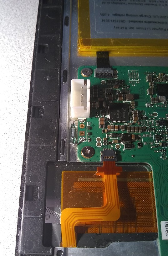

This undoubtedly works on something, but I've never experienced it.
I'm not sure whether the sensing occurs in the abl or in the actual Qualcomm ROM bootloader.
Onyx is pretty good about making the EDL test point obvious.
Of course the hassle is opening the case.
I've posted this a zillion times already. It's a magnetic reed switch I put in so that I can always get to EDL without opening the case.
My opinion is that it's easier to add rooted ADB to stock recovery than it is to port TWRP and add all the properties of your stock device.

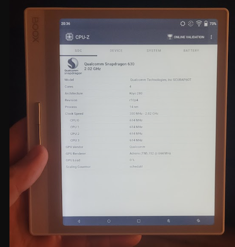

As for CPU, it is probably QCS 2290 in Leaf 2
That could well be, but naming by Qualcomm is so screwed up.
I thought from the (Chinese) video from Onyx that it was a SnapDragon 630.
What does cat /proc/cpuinfo show? Quad or Octo? Bengal?

CPU Info doesn't show CPU type, but GPU is detected as Adreno 702, which is used in QCS 2290.
Glad I could help!
I installed CPU-Z from F-Droid and it does show Snapdragon 630.
This is the output:

Hardware	: Qualcomm Technologies, Inc SCUBAPIIOT

Has anybody checked out EDL yet?
The HWID is the only unambiguous ID.
If it is a 630 then the same EDL loader should (probably) work as for the Poke3.

When I use your tool over at XDA I get this error:
.\edl.exe /l
Found EDL 9008
Could not open device
EDIT: My bad, removed the Qualcomm drivers and used Zadig as you recommended:
HWID: 001860e100000000, QC: 001860e1, OEM: 0000, Model: 0000
Hash: d40eee56f3194665-574109a39267724a-e7944134cd53cb76-7e293d3c40497955

001860e1
Oh, you mean "QCS_AGATTI"?
(Qualcomm naming will be the death of me.)
Why didn't you try actually loading a loader?
A link for the Poke3 loader is on my EDL page.
And then try listing the GPT.
It looks like this is more similar to a SDM662.
I think that identification with the SDM630 is in error?
Try this loader here: https://www.mobileread.com/forums/sh...&postcount=107

See the picture of CPU inside Poke 4 Lite at this site, could be the same as Leaf 2:
club.dns-shop.ru/review/t-81-elektronnyie-knigi/76304-obzor-elektronnoi-knigi-onyx-boox-poke-4-lite
